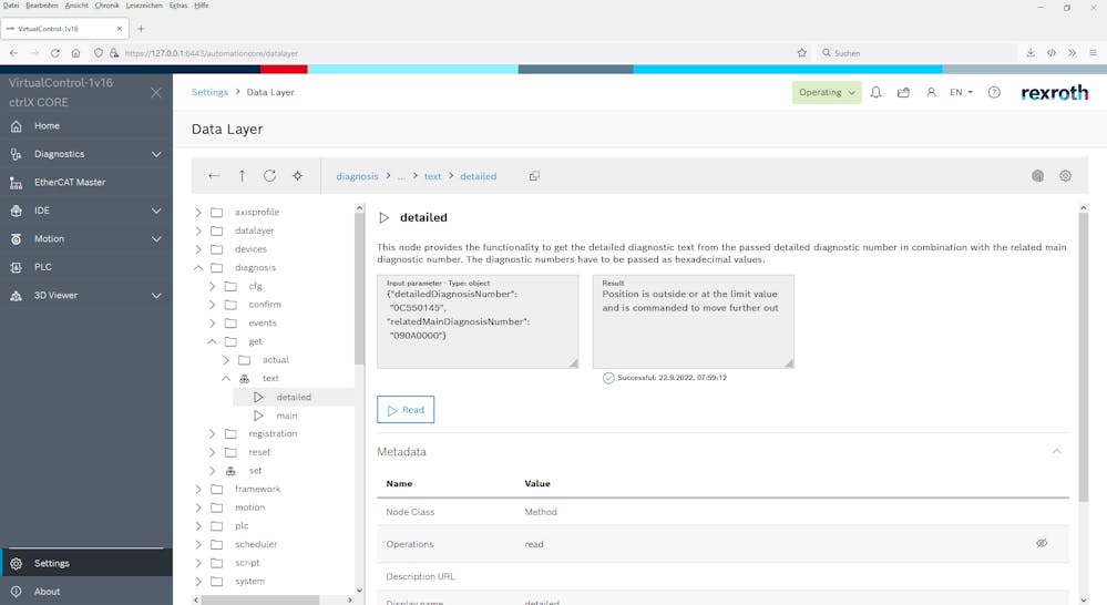

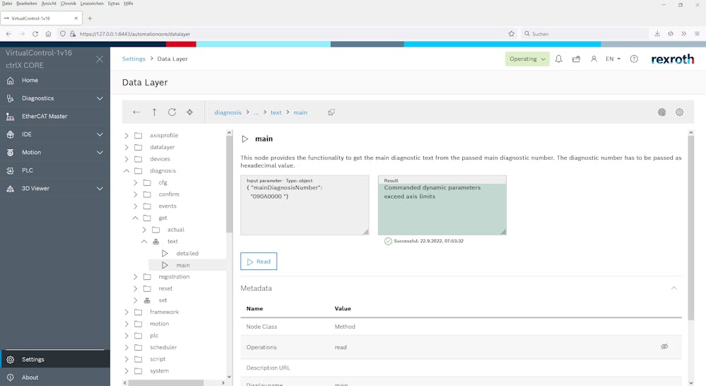

In the Data Layer viewer it works as you can see here:
For main diagnosis number send object '{"mainDiagnosisNumber": "090A0000"}':
Data Layer viewer get main diagnosis text
For detail diagnosis number send object '{"detailedDiagnosisNumber": "0C550145", "relatedMainDiagnosisNumber": "090A0000"}':
Data Layer viewer get detailed diagnosis text
