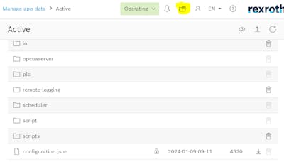

Modify the IP-adress and filenames according to your settings.
This can download files from the APP data folders of the core, in the example above the configuration.json file:
