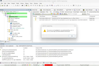

FB CyclicStatusDataInit Error
I'm getting an error with the Axis Interface.  Specifically the chunk of code added in 2.6 for the function CyclicStatusDataInit.  This is a 30+ axis count system.  See the screenshot below for reference.  What is the source of this error?  I don't have access to that code in the motion interface library.
Best reply by Jochen_Mueller
Hello EngJay
That's a known bug. There will be a hotfix as soon as possible available in few weeks.
For rexroth member there will be a intenal testversion. If you need it give me a privat message.
Regards
Jochen Müller
