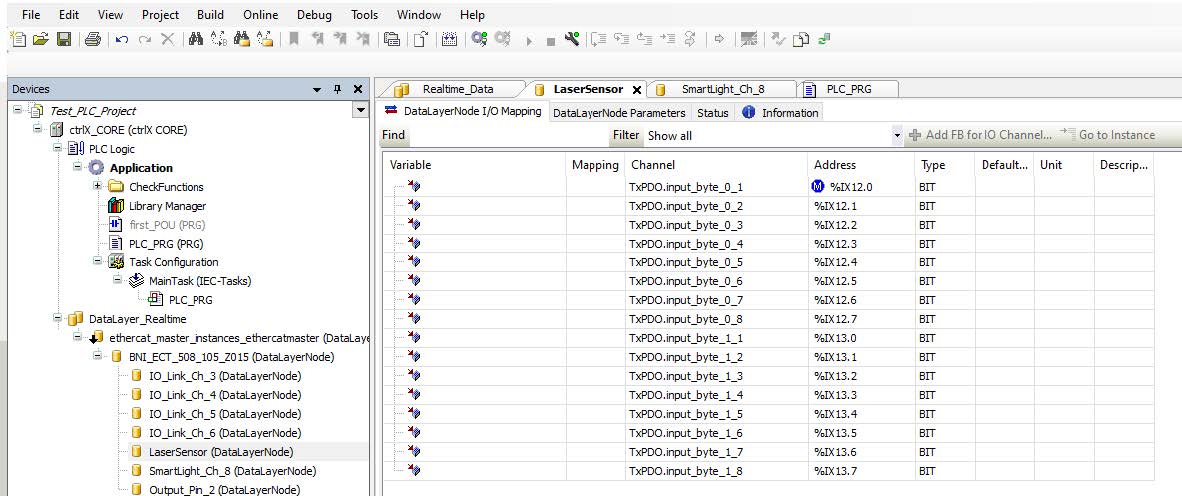

Balluf IO-Link devices in Codesys V3.5 SP16.2 can use a feature to get the Process Data as type Bytes which creates Mapping nodes that would help ease the mapping process into PLC program variables.
See attached picture.

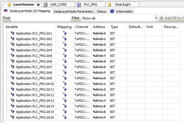

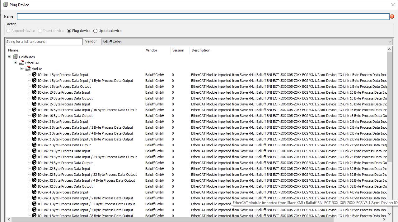

When Installed on Bosch Rexroth I/O Engineering tool software, The feature of BYTE type process data doesn’t show up (Grey IO logo) [Figure 2] and also no Mapping-Nodes available [Figure 3].

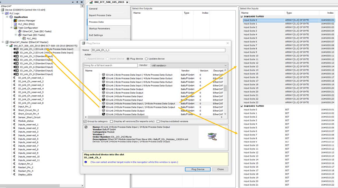

So the bit mapping has to be done BIT by BIT example [Figure 4].
So is this an issue of "there is no gray I/O icon" available when using ctrlx I/O Engineering vs. codesys? In the codesys installation every possible slave device config is offered two times: one time with "bit-wise-mapping" other time with "byte-wise-mapping"
