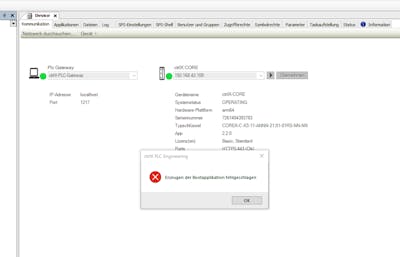

So I'm using A COREX-C-X3-11-ANNN-21.01-01RS-NN-NN (X3_System_Apps_RM 23.07.1) device with the PLC application in version PLC PLC-V-0202.0
I noticed I needed to update my CtlrX Works to version 1.20.5 in order to be able to communicate with the PLC, in all other versions I got odd licensing problems (which possibly are releated to the new name of the license for the PLC runtime).
So I tried deploying my existing program and the IDE updated the settings to the new version.
However as soon as I try connecting and deploying the application, I get a popup saying "Erzeugen der Bootapplikation fehlgeschlagen" (Error creating bootapplication)
and from then on I see a red flashing "Programm geladen: AUSNAHMEFEHLER" at the bottom.

Best reply by Inactive Member
well I had updated my PLC to 2.2 so I could no-longer work with CtrlX WORKS 1.20.5, but in the end I finally found where to find it (In the "apps" section and not where I would have expected it: "in the base in paralell to CtlX CORE")
Problem solved.
