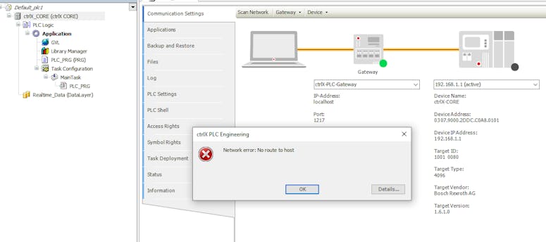

I am trying to login to the PLC, but I get the below message.
I can access ctrlX Core though through the main Home page.

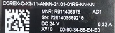

the CORE is the following device: (FD:21W07)

Hi Jochen,
Thank you for reminding me, I checked all the system apps, and some of them were not actually updated, I think I missed to reboot after the failure messages that comes after some apps.
After updating the System apps, I was back to older issue of not being able to login (Invalid user authentication), I checked all the other apps, and I found the Remote Agent app with the old version (1.6), so I uninstalled it completely, and now I can login to the PLC.
I was under the impression that even if some apps are outdated, they should not affect the other apps, this is one of the benefits of having Snaps in the first place, which is all the dependencies of a given app is installed with it.
