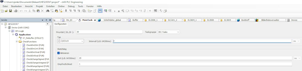

is there a way to set the cycle time of the main task to less than 1MS? I looked directly at codesys and there I can set the time to 50µs
However, we used a different PLC for the codesys program.

codesys:
Bosch Core:
In a ctrlX CORE the the standard scheduler for PLC tasks is working in 1ms cycle time at the moment, so the tasks cannot be set faster.
You could use another event to trigger you task faster created directly in the ctrlX COREs scheduler. But at the moment also there is minimum time of 500µs.
