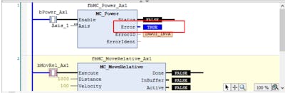

I am using ctrlX drive demo unit with PLCopen library ladder programming,ย
When i used MC_Power function block whenever i logged in it will show Error, i tried resetting Warm, Cold and Origin still the same.
But however when i use structured text it has no issue.
Anyone encounter the same issue?
please see attached.

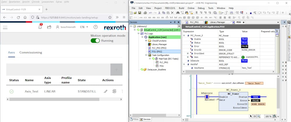

Which versions of the ctrlX PLC Engineering, CXA_PLCopen library and ctrlX PLC app are you using?
The error tels us that the input is wrong. I can confirm this behaviour (Version 1.12) as long as the AXIS_REF is not set correct. But it is working fine when set correctly:
ctrlX Motion axis CXA_PLCopen.MC_Power LD
