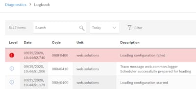

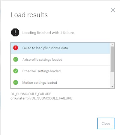

I keep getting the same error: Failed to load PLC runtime.
Rebooting the CORE does solve this issue as the Configuration then gets loaded correctly and I can run my PLC Program. However if I want to configure PLC Remotely rebooting the CORE every time a configuration is changed is not an option.
