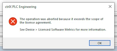

I have the following problem when using an existing Codesys project and making it run on the X3 hardware. I get the following error when committing:

Please can you give me some hints to fix it.
Your app version are quite a mix from version 1.20 and 2.4 what can lead to unintended behaviour and should not be used like that for productive purposes.Â
Could you also add a screenshot of the PLC logger?
In a last instance you could send me your contact data via a private message so we can follow the steps together, as this is the way to go.
