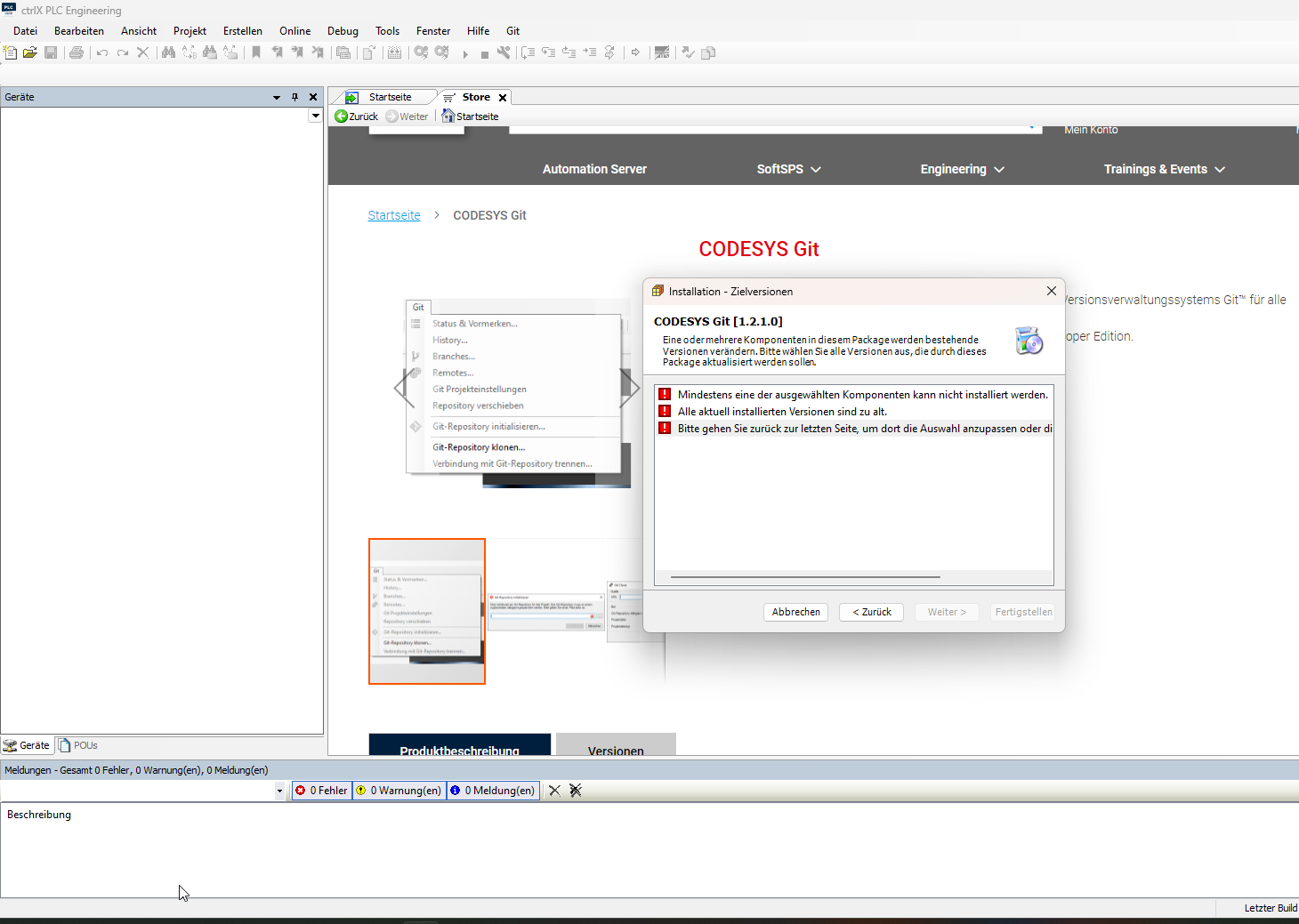

Hello everyone, I'm trying to integrate the latest version of GIT hub into ctrlX PLC, but I always get the following message (see picture) is there a fix for this?
Best reply by georkueh
if you have a look on the CODESYS Store (https://store.codesys.com/de/codesys-git.html) you can see, that CODESYS 3.5.18.20 is needed to run the version CODESYS Git 1.2.1.0. here you need ctrlX WORKs 1.18 or higher.
Alternatively you can download CODESYS Git 1.1.0.0 to install it on ctrlX PLC Engineering 1.12.
