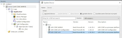

I performed this migration updating the device. Right click on Device --> Update Device --> Switch from arm64 to amd64:
