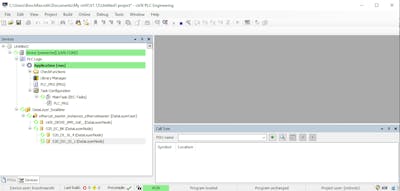

I have a problem with generating code for PLC app of a ctrlX Core.

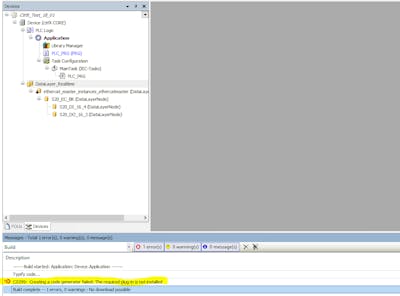

I added an etherchat bus coupler with 2 I/O modules, in order to try to do a first simple logic, and I got the error C0299 (The required plug-in is not installed).
I missed something from installation? What's wrong in my project?
I have installed only the PLC app and Ethercat Master App.

Hello Vlad
I have tested this and see no problems.
I'm using the new release RM21.11.
  • Do you install the additional Codesys packages? (will be found beside the ctrlX WORKS setup.exe)
  • Do you have all necessary licenses?
