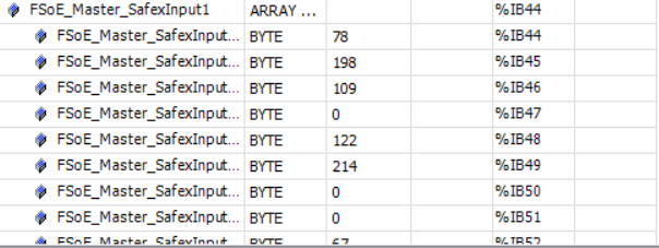

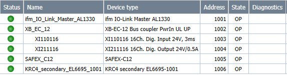

I am using PLC, Works and IO version 1.20.5. I have connected PLC with IO module, safeX, Kuka robot and IO Link Master. I am facing issue, when i have connected 8 byte in/8 byte out IO Link Master module to the PLC at that time bit is fluctualting and connection cannot established properly. IO engineering's bus topology shown green. There is no issue in connection but when i replace 8 Bytes data to 16 Bytes in IO enginerring at that time connection established. actual gripper has 8 bytes data. please help me out for this problem.
