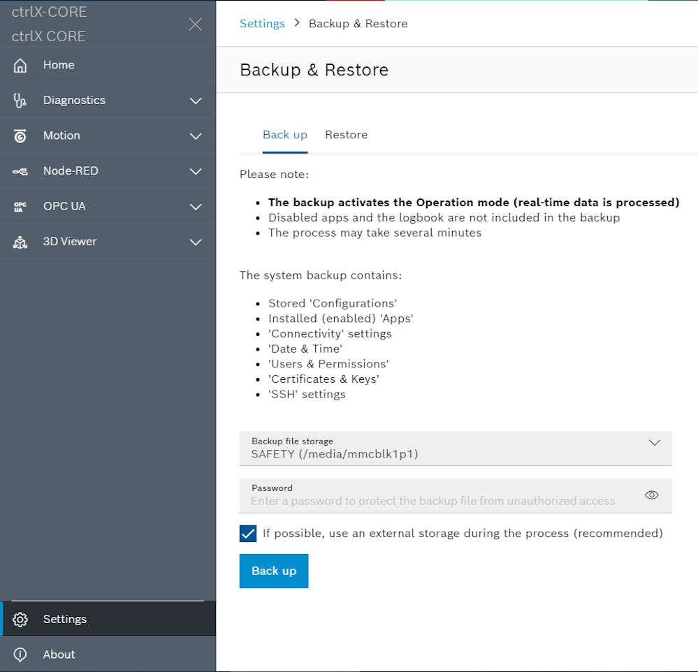

See general information about Backup/Restore​in our online docunemtation. There is already mentioned, what is inside while creating the backup itself:
ctrlX CORE web UI - Backup 1.20

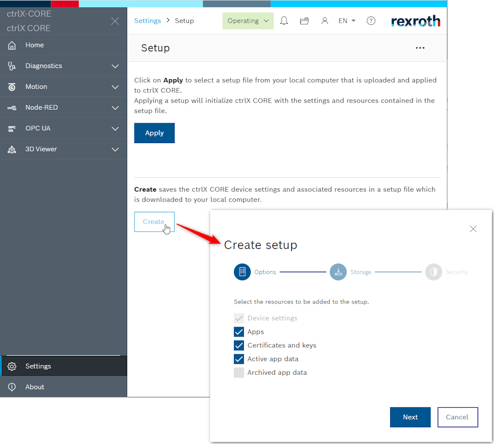

See general information about Setup​in our online docunemtation. There is already mentioned and you can choose, what is inside while creating the Setup itself. The chooseability will increase in the coming versions:
ctrlX CORE web UI - Create setup 1.20
