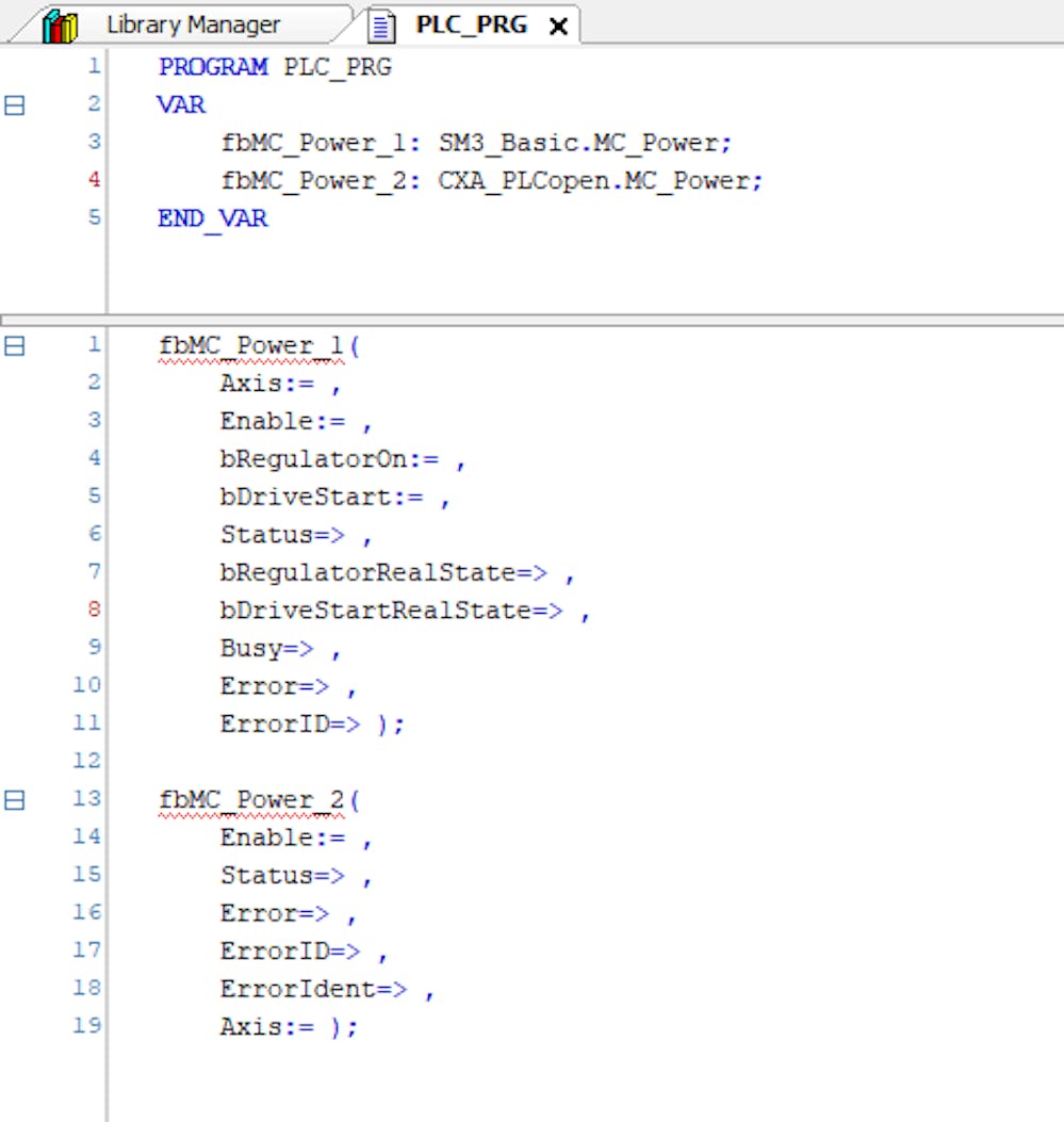

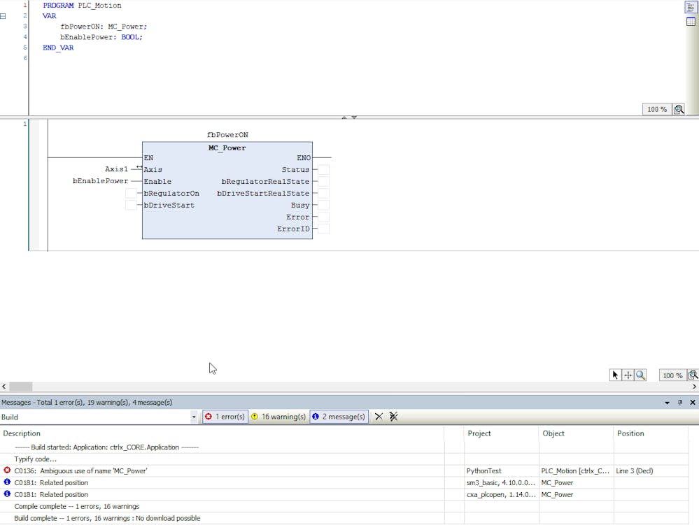

I have been trying to command an axis via function blocks of the PLCOpen Library,
I have installed the SoftMotion Package 4.1.0 and I have the 1.14 version of the PLCOpen Library
The problem comes when I instance any function block of this library. If I generate the Code of the PLC Program it returns a " Ambiguous use of Name "MC_FB" " error. I have changed the name several times but it continues to return this error.
