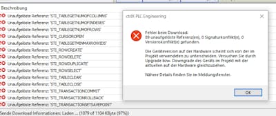

I’m trying to implement the alarm management in my PLC project following the CtrlX PLC Engineering documentation.
1. When an alarm storage is added to the application, I get a bunch of errors while downloading the code.
2. I want to get the active alarm messages out of the PLC App and was trying to copy them to the DL by calling the GetActiveAlarms method of the IAlarmManagerClient. Is that a reasonable way in CtrlX?
The alarm management package is actually not usable but it is under investigation by our R&D.
EDIT: Feature is planned for Version 1.16 coming up end of July this year.

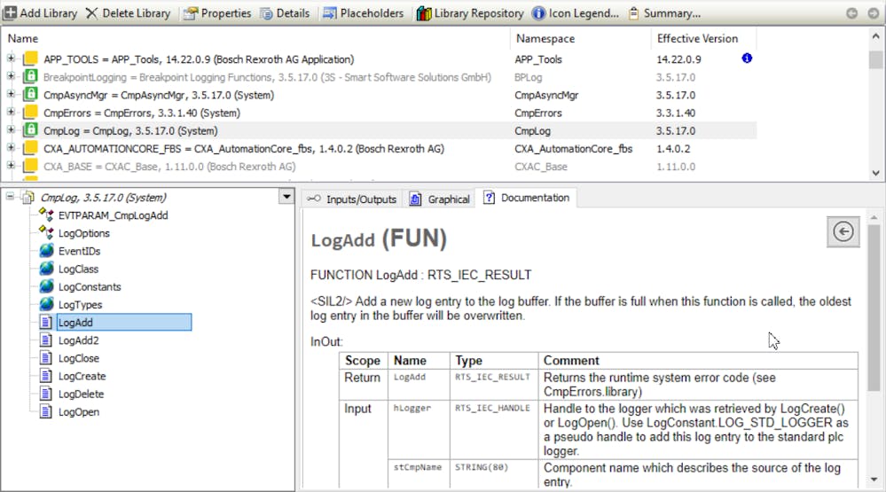

For adding errors to the logbook of the ctrlX CORE simply use the LogAdd function out of the CmpLog library. The PLC logger messages will automatically be transferred to the main logbook.
