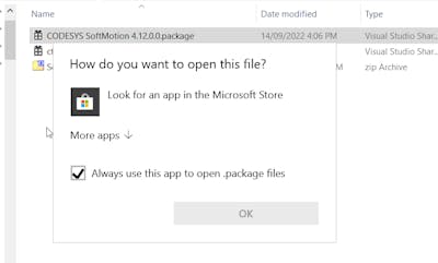

I'm trying to install a package inside CtrlX PLC Enginerring. In the past I've used Tools->Package Installer.
This seems to have been replaced by Tool->Add-On Installer. When I open this, I can't figure out how to install packages.
I click on "Browse" but this brings up a display window not a selection window. If you click on a .package file a w
indow pops up asking what application you want to use to open the file

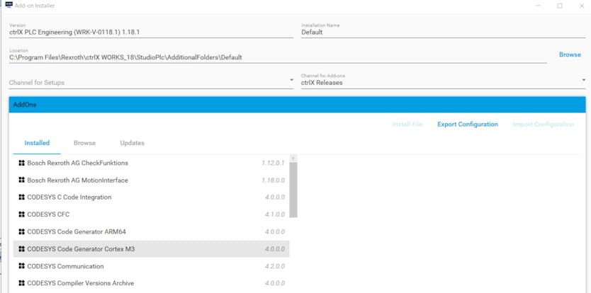

Please use the "Install File" button. This worked for me:
ctrlX PLC Engineering install package
EDIT: Administrator rights are needed.
