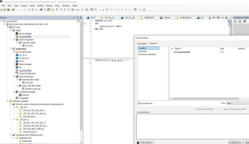

Is it possible to connect from a 2nd application to the data layer to communicate i.e. global variables between both applications?
Currently I can find the data via <F2> only in the 1st application of the device at IoConfig_Globals_Mapping.
