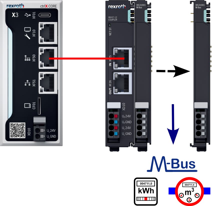

The CXA_MBus library should be used in conjunction with the ctrlX I/O XI531001 1Ch. M-Bus master communication module (R911423593). The ctrlX I/O XI531001 can operate either locally on a ctrlX CORE or decentrally with a bus coupler and can communicate with up to 50 M-bus devices.
