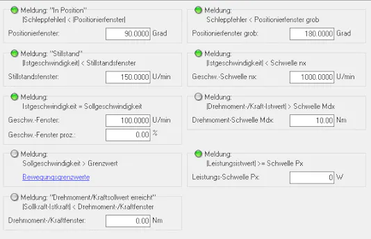

And there are no limits in drive (except speed):
And no issues with any status reports from drive:
