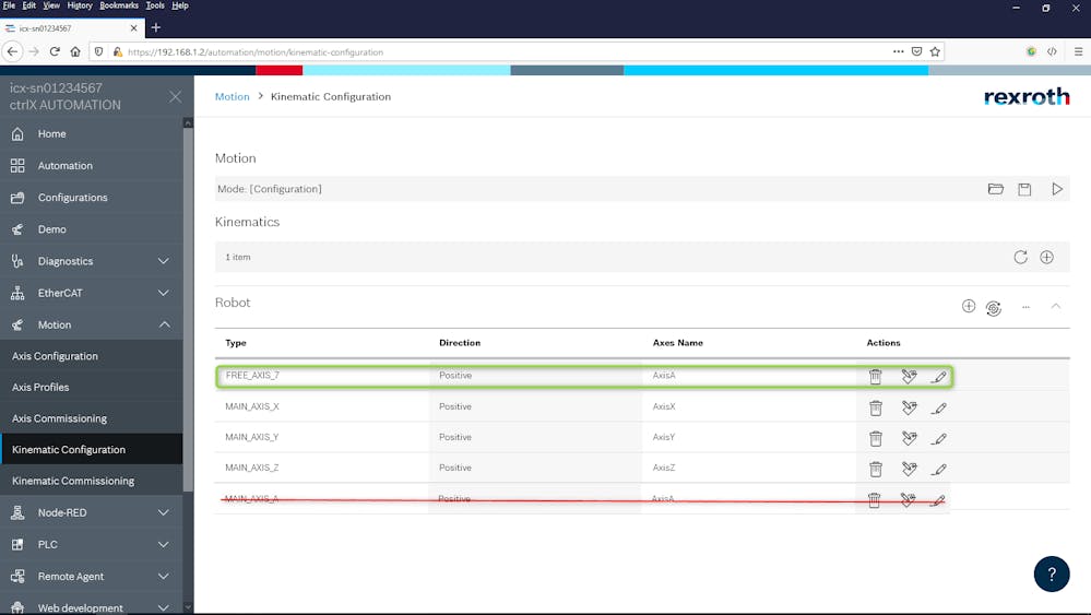

In the ctrlX MOTION version 1.0.4 it is not possible to group an robot when an axis is matched to the meaning "MAIN_AXIS_A", "MAIN_AXIS_B" or "MAIN_AXIS_C".
If you need have auxiliary axis please use the meaning "FREE_AXIS_x".
