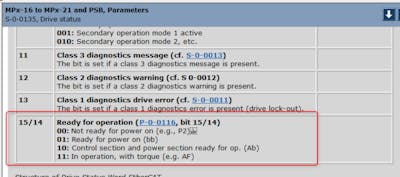

With PLCOpen  (maybe also with AxisInterface) I can't see how to access the power up status of a drive ie. bits 15/14 of S-0-0135 Status Word. I want to use the status bits in some logic for MC_Power.Enable so I don't enable when there is no power.
I could do a non real time access to the datalayer but I would prefer to use the cyclic data from S-0-0135.

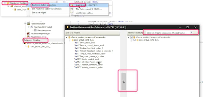

But you could read the S-135 in the PLC programm. Or is this way not what you want.
I just tried in my PLCopen test programm: It works:
1) Import at Datalayer-Realtime node:

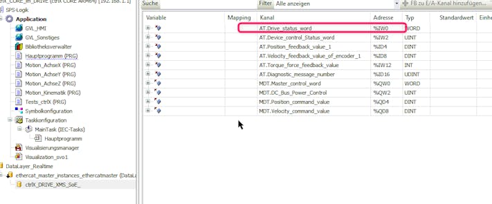

2) Then you have i.e. at %IW0 the state word S-135 (in my case)
3) Then it's clear for you:
