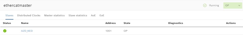

At first I did the IO Engineering and set up the Ethercat Master, everything is working.

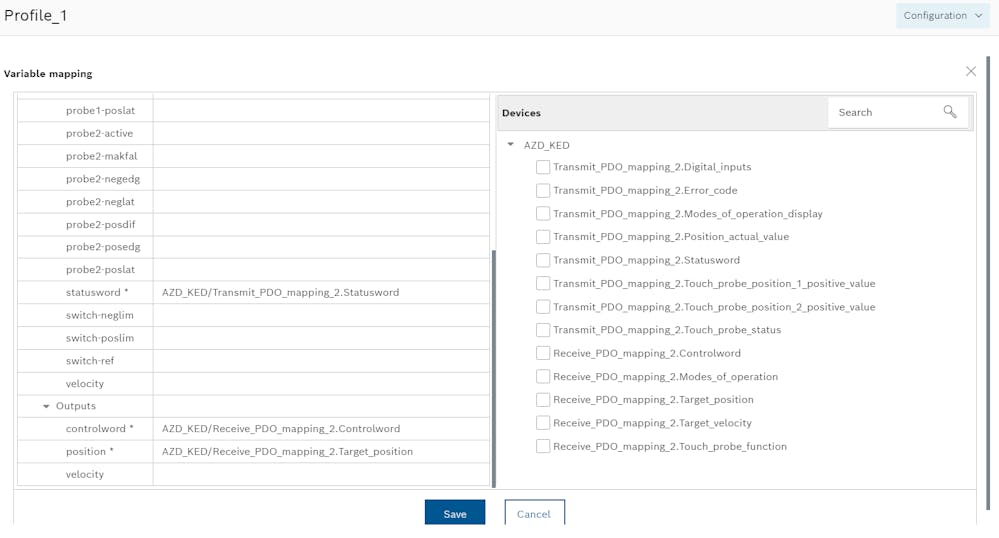

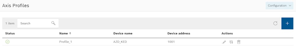

Then I created the matching Axis Profil and mapped all of the four variables.

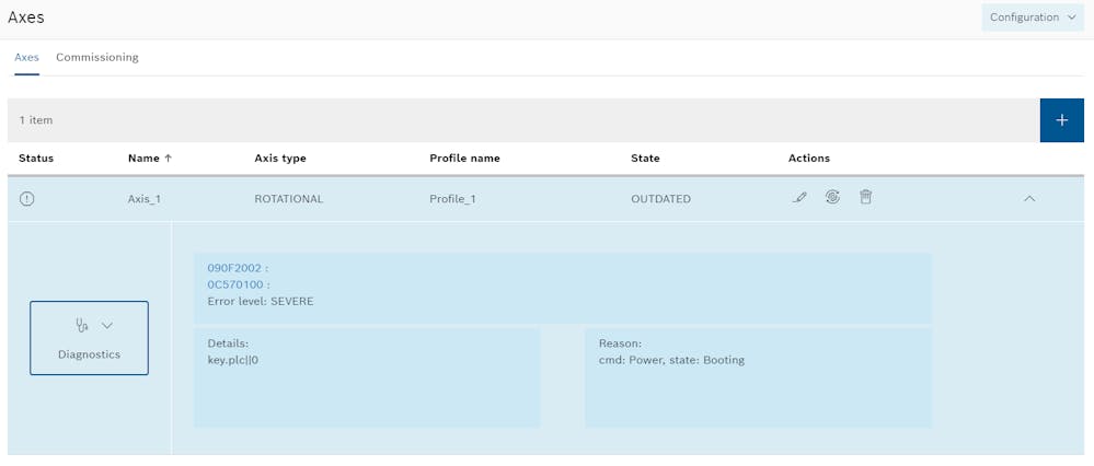

Then I created the Axis in the Motion app and connect the Axis profile.

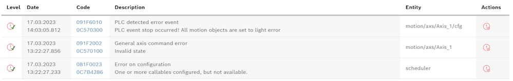

When I know try to run the Motion app, i will get an error, see in the picture above.

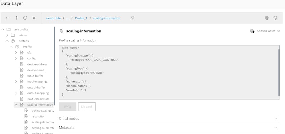

This are the changes i did in the data layer based on other threads.

Our ctrlX MOTION is expecting/using a CiA402 protocol standard. Please check your drive does support this.
Could you please have a look to this thread for further information?
