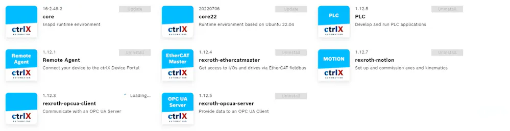

ctrlX works 1.12.3.Â

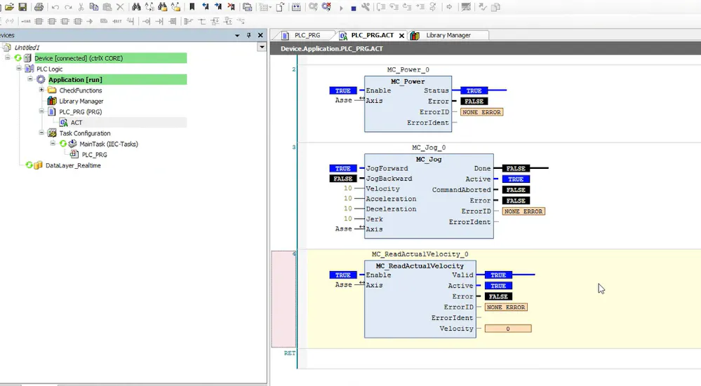

If we try to read the velocity of a real axis we have no feedback. In other hands the FB is working perfectly with a virtual axis.Â

-> The PLC open FB MC_ReadActualVelocity don't gives you any velocity data from the real drive (virtual it is working)

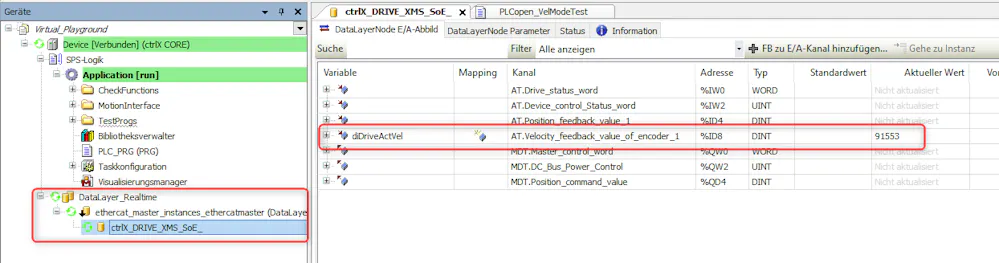

The only possiblity to get the drive veloctiy at the PLC, you have to map the value at the DataLayer_Realtime inside the PLC-Engineering. -> see Screenshot. Here I make a global variable mapped to the AT.Velocity_feedback_value_of_encoder_1. You see the Value 91552 = 9,1552 RPM (DINT value)
notes:
the DataLayerRealtime looks different at your version. Because I have done the screenshot with the version 1.16. But the principe is the same.
You have to use the variable somewhere at the implementation that the value will be updated.
