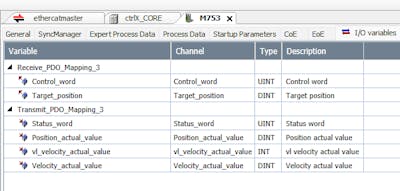

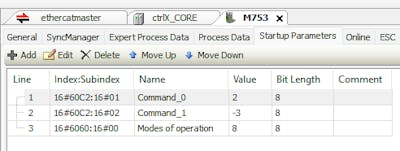

 We try to set up a Nidec Digitax M753 via Ethercat (CoE) with our Core X3. (SM01.20.5)

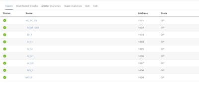

We managed to set up axis profile and axis. If we move the drive via Inverter, the current position changes on our Web interface (Core).
So communication it self is working.
As soon as we set the power on (either via MC_Power or via Web interface) we get the following error.
We tried several things described in other topics regarding that issue but nithing solved it.
Does anyone has an idea what to do next?
Thanks a lot
