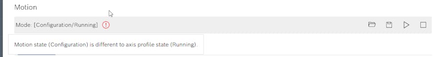

Motion state (Configuration) is different to axis profile state (Running)
I have some difficulties commissioning the ctrlX core with Indradrive Cs.
Version 1.08. (all apps are 1.08) Everything seems to work except the comissioning of the Axis Profile

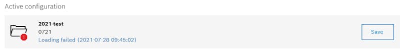

The problem starts with not being able to "reset" the ctrlX core. I cannot load an empty configuration.
So I manually deleted everything. Even de-installed the apps and started over again. But maybe here the problem already exists.

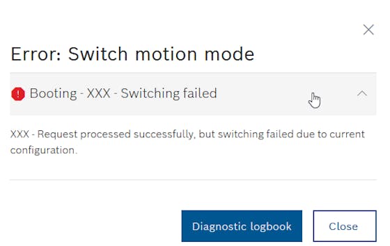

When I commisioned everything and I like to configure the Axis profile setting I can stop the porces, configure and link the variables, but its not possible to get in run again. Different errors occurs. Sometimes I loose connection and the ctrlX makes a reboot.
You see the "run"and "stop " button both available. But it's not possible to "run" the application.

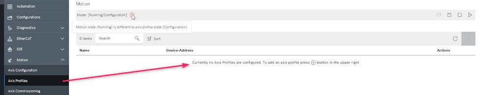

Strange thing is: Even without an Axis Profile in the ctrlX, after a reboot the still the error appears about the profile state.

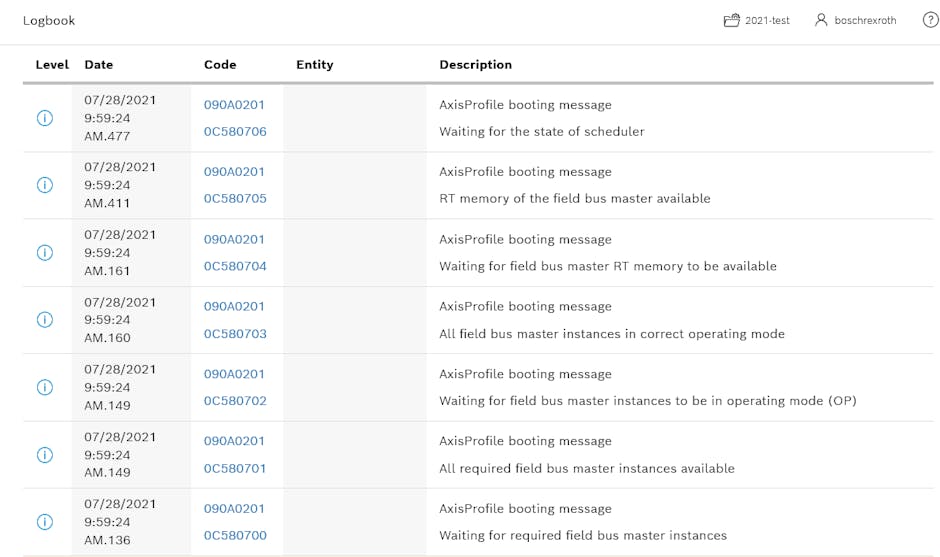

In the Log one warning is active
Diagnostic_Log_2021-07-28_10-39-11.csv
