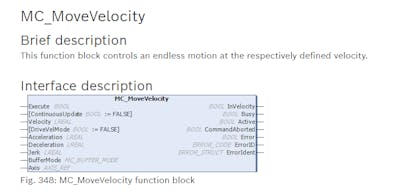

Hello Team,Â
In the FB MC_MoveVelocity, we have an Input name continuousUpdate, which "Update the Velocity cmd as soon as we have a new one ? ",Â
but it seems that it is not working, do we have something special to do ?Â

"ContinuousUpdate" is an optional input in the PLCopen standard and is only attached for future use. At the moment no functionality is connected to it.
