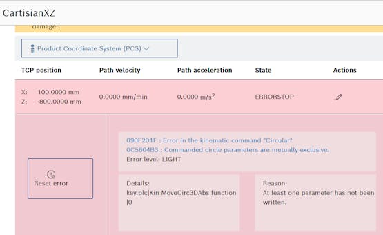

Is it possible to use a Robot 3D circular interpolation function in 2D Cartesian XZ robot ?
Is it possible to use the 3D circular interpolation function to make a 2D circular interpolation for example for a XZ cartesian robot or I must use the 2D circular interpolation functions?
Here you have my code: if I run it for the 3 axis intepolatin plane XYZ is working good but I get an error when I run it for the 2 axis interpolation XZ
