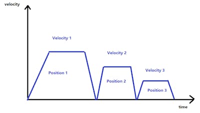

For example, when there are three position movement with three velocity in single axis, we know it can be done by sending three motion command (axsPosCmd) to motion APP in buffer mode. But in this mode, the velocity will reduce to 0 from one positioning to next positioning like the graph showed below:

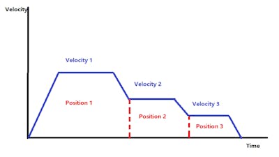

We want to achieve blending smooth velocity change from one positioning to next positioning,like the below graph:

You are totally right. Sorry for that, I just used some standard values for my tests and can confirm your behavior.
It seems that blending of buffered commands for single axis is not possible at the moment. I will have an discussion  with our R&D and suggest to read out the position cyclically and send new movement command unbuffered accordingly.
