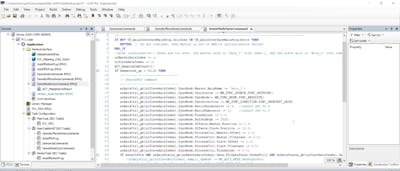

In the ctrlX MOTION there is no difference between the real and the virtual axes as it is always a calculated motion object. Just add e.g. "Axis_1" via the ctrlX CORE web UI and then it can be used in the PLC.
The reference as you can see in line 15 of the template code is the name given to the axis in the motion.
Â
arAxisCtrl_gb[uiSlaveAxisIndex].SyncMode.Master.AxisName := 'Axis_1';Â
