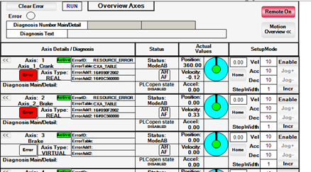

Could someone please help me with the PLC error which shows up only when the machine restarts, please find the error in the attachment?
Error ID: RESOURCE ERROR
ERRORTABLE: CXA_TABLE
ERRORADD1: 16#090F2002
ERRORADD2: 16#0C560000

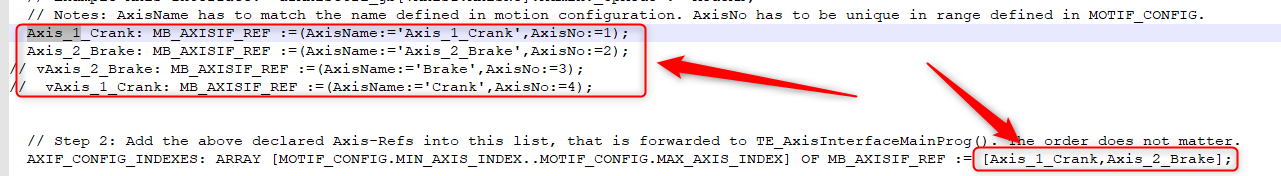

I understood that its something to do it naming of the axis, am I right?

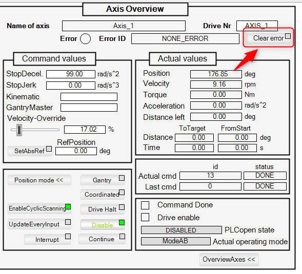

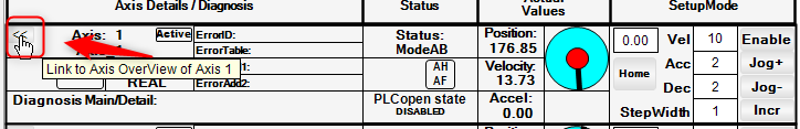

AxisName is kept the same as in the motion app in the Core, but still i get this error only when the machine starts and I can only clear this error by going in to the axis overview not from the Overview Axes in the PLC like as in the image 1 and 2 for reference.

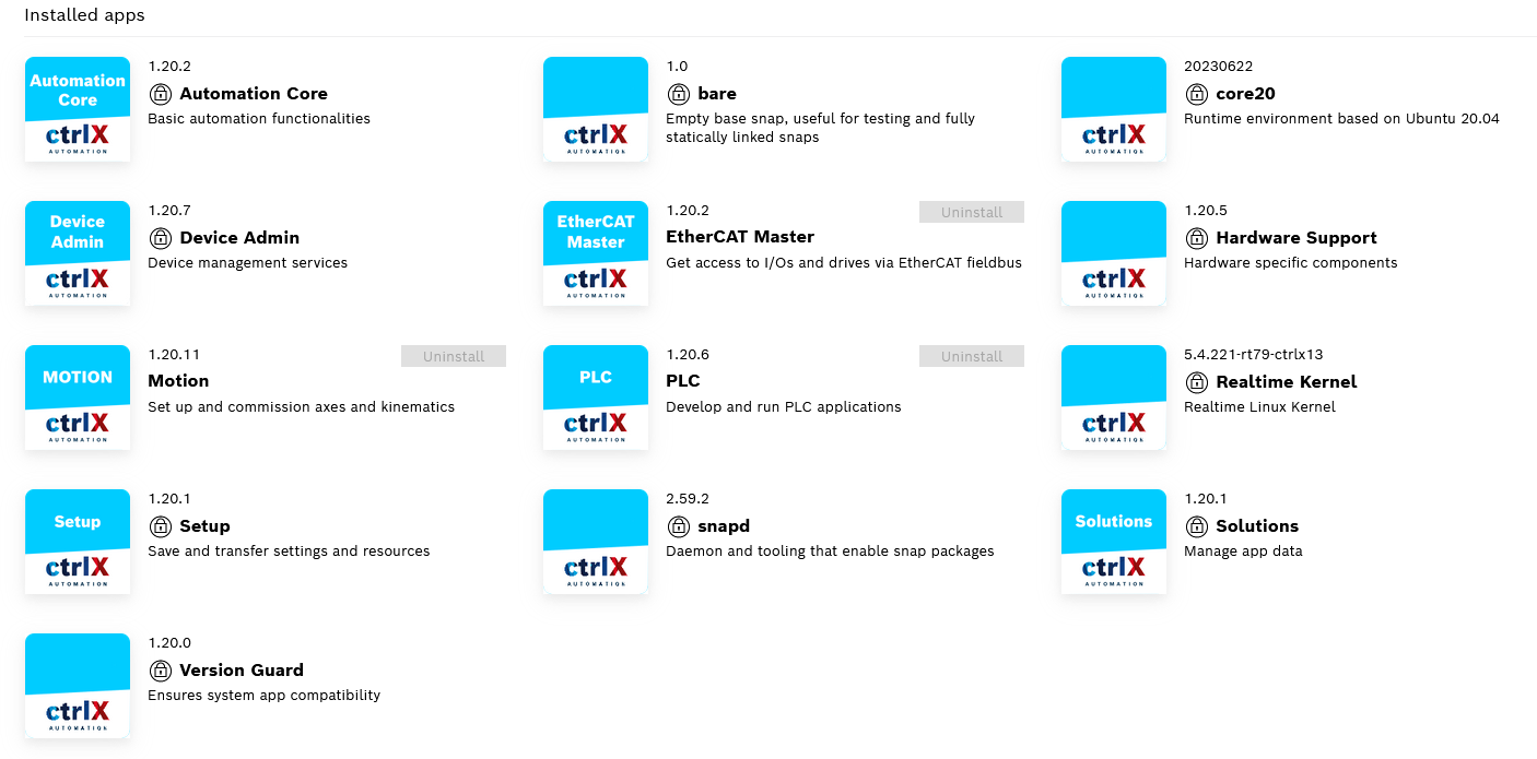

App version in the attachments. i am using the axis interface to control the axis.
