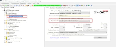

I'm trying to power on an XCS drive via Ctrlx PLC Open  MC_Power function block and I got the error you can see in the attached screenshots. The drive status is in "Ab" but when I set the "Execute" bit to the FB I got the error.
Could you help me to understand why ??

I had to set the Communication profile as shown in the screeshot below
