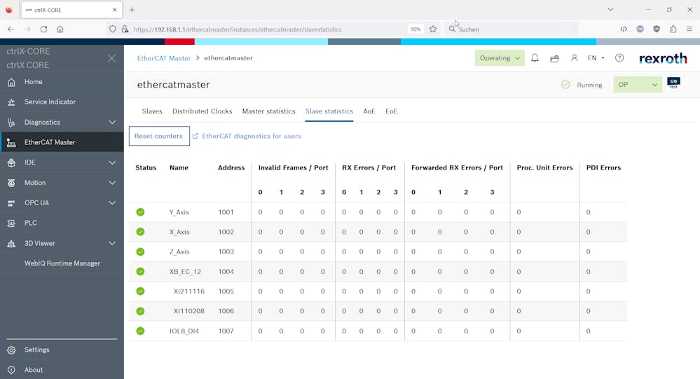

  • Could you please check the slave statistics of the EtherCat master, to localize where disturbances are happening:
ctrlX CORE Web UI - EtherCat slave statistics
