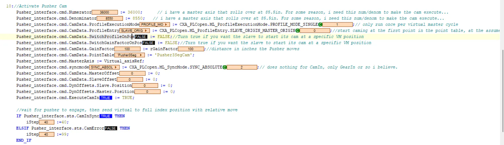

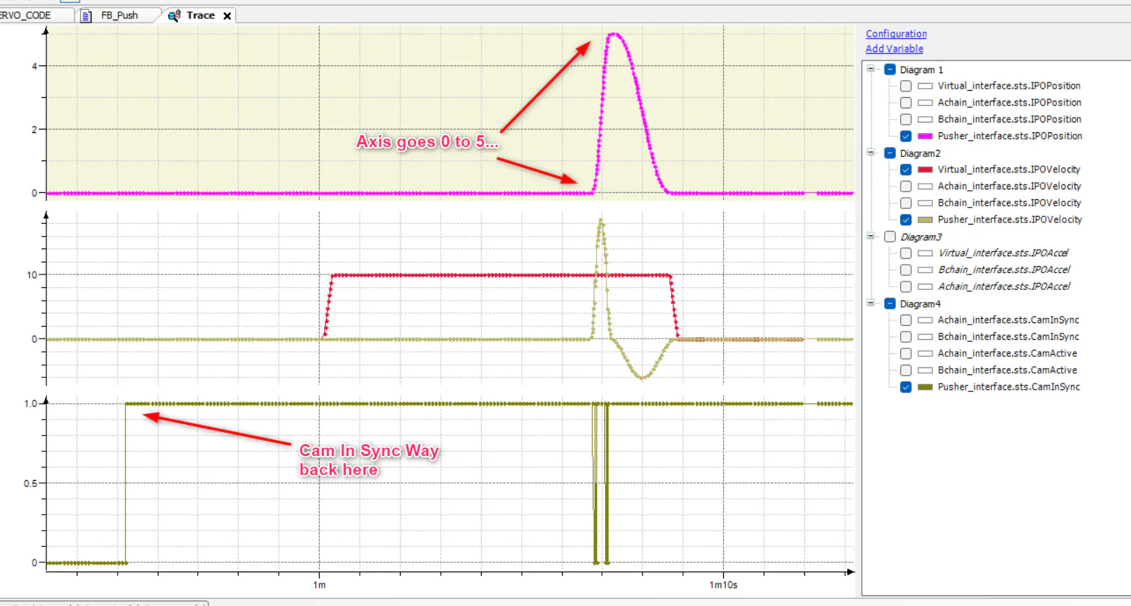

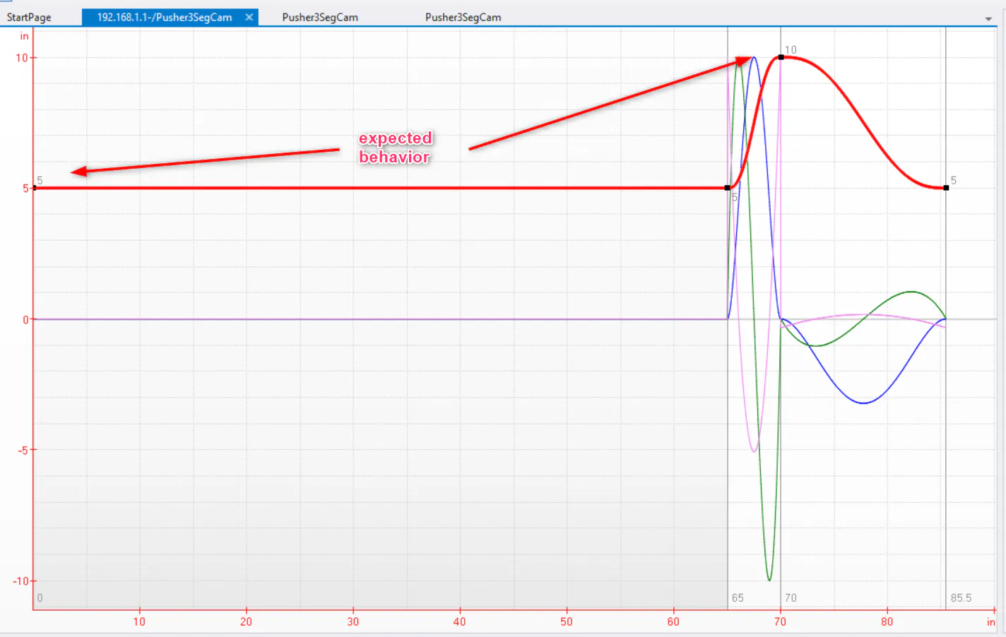

I have created a cam that goes from 5in to 10in and back, but when when I CamIn into the points table, my axis goes from 0in to 5in.
Can we not CamIn to a points table at an absolute position?
Below is my CamIn Config:

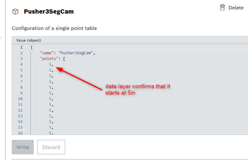

Below is the datalayer/points table showing that the cam should start at 5in.
