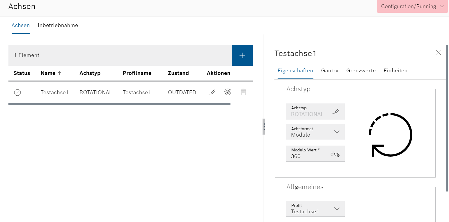

We configured the axis and the axisprofile, linked them and set the EtherCAT Adress (see Screenshots).

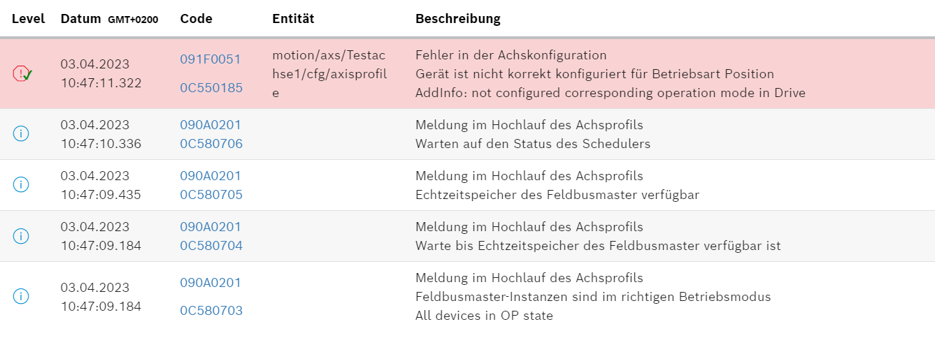

When i want to set the motion app to "Run" i get the error "091F0051/0C550185 (see Screenshot).

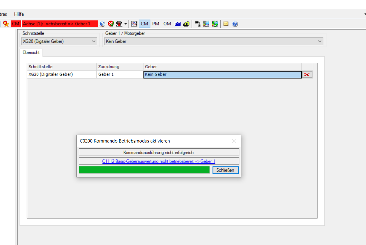

I tried to set the encoder interface to "XG20" and  encoder 1 to "no Encoder" but when i want to set the drive to Operational i get a endoder fault "C1112".

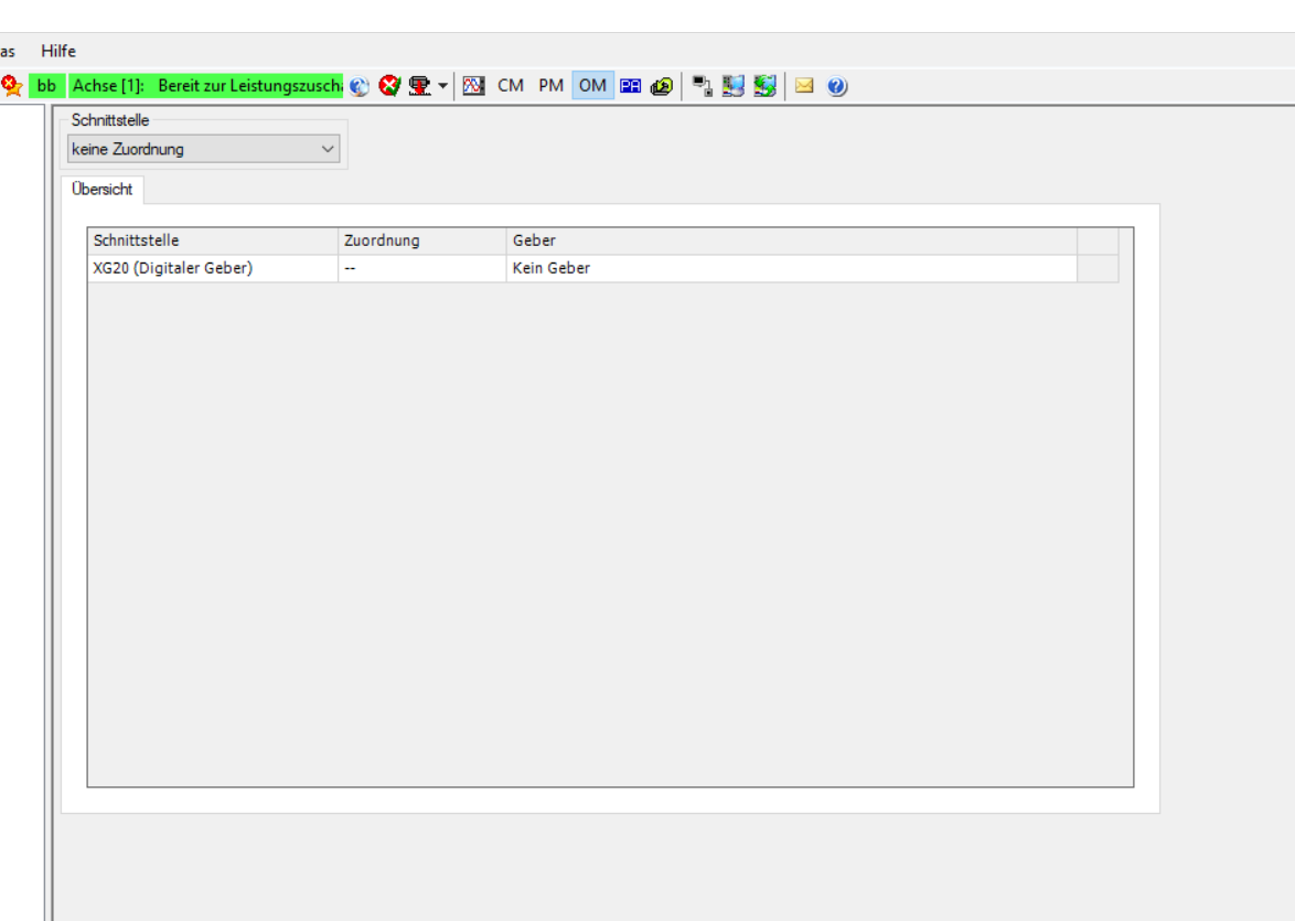

When the interface is set to "no assignment" the drive can be set with the Drive engineering to Operation Mode wihtout a fault.

As cyclic position control lagless is the main and mandatory operation mode for our ctrlX MOTION your usecase is not possible right now, as the ctrlX DRIVE cannot be set up accordingly.
By the way, in the ctrlX IO Engineering you would have to look to the startup parameters of the SoE slave, as for a ctrlX DRIVE the main operation mode in standard will be set there to position lagless.
