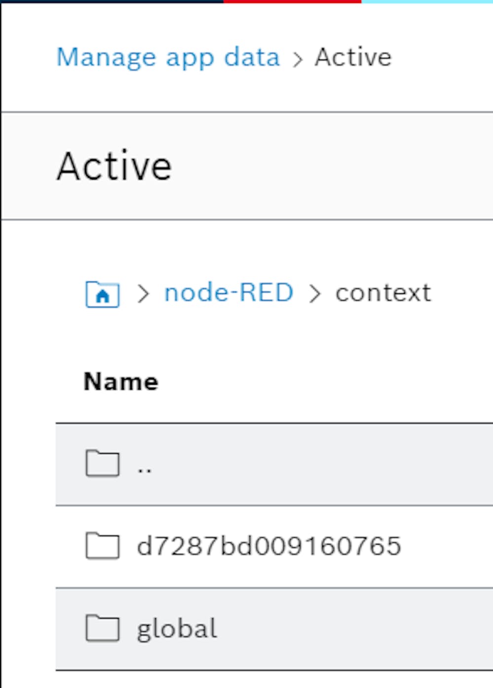

Local file system storage is enabled on the ctrlx Node-RED distribution. Every 60s the Node-RED file context is saved to the Node-RED app data /context directory.

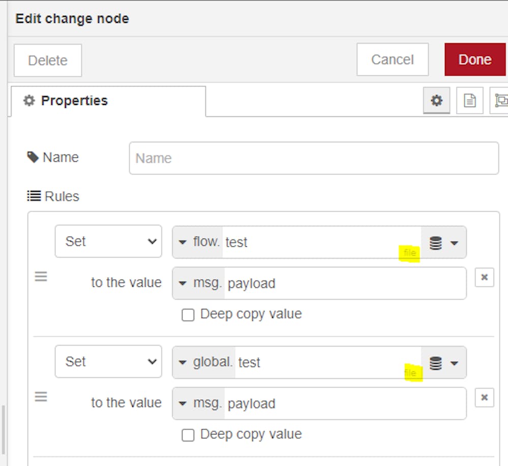

 You can write values using the change node. Example below.
