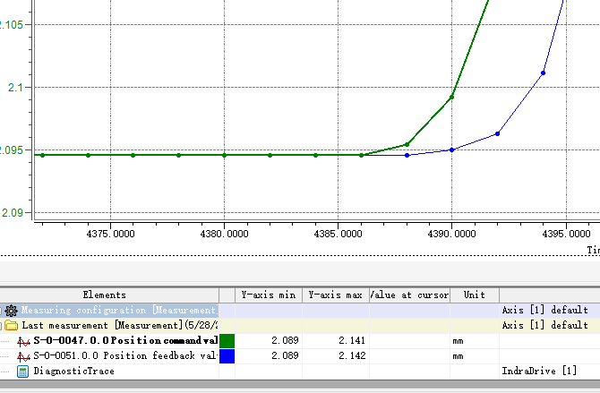

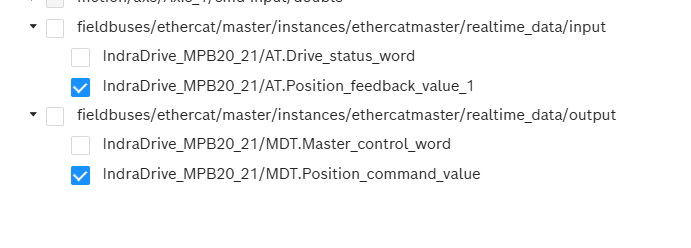

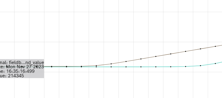

In the picture, the test engineer is tracking S-0-0047 Position Command Value and S-0-0051 Position Feedback Value.  For visualizatoin, he used both Oscilloscope APP in ctrlX CORE and oscilloscope function in ctrlX Drive engineering to track the signal values.
After comparison, the result shows that there is an apparent delay of signal incoming about 5~6 cycle time in the Oscilloscope APP which is running on ctrlX CORE as real-time task. They also tried with ctrlX CORE X3 and X7, and both hardware gave the same result.

This is not a bug neither a configuration mistake, but a conceptual error.
  1. First of all, Oscilloscope is a signal collector, it only displays the measurement
  2. The sources of these two devices are different. The signal on Drive Engineering is drive's own internal cycle. The signal on the fieldbus node of ethercatmaster is the drive signal obtained by ehtercatMaster through the mailbox protocl
  3. The mailbox protocol is a non-real-time protocol, so the signal of ECM obtained is a NRT signal relative to Drive, so thet will be out of sync and there will be delay
  4. The so-called synchronization refers to the apps on the ctrlX CORE(ECM. MOT, OSC...).  thet are all scheduled by the scheduler and they are synchronized in real time
tip:
if you want to use Oscilloscope to measure drive signals, please use OSC-V-0206 with DCA app
