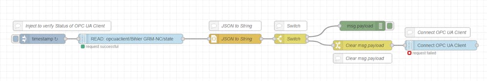

Best reply by leonberger-m
Hi jacaré
please find enclosed the flow I am currently using. First I used the Ctrlx subscription node to trigger the state. Meanwhile we have switched to an inject node with an initial start + interval. This prevents if machine is switched off that there will be no reconnect after powering on the machine.
Currently we are using 15 seconds. You only have to change the READ node to your own OPC UA client state.
JSON Flow to import to your node red:

"id": "c2fc2f58b41274b3",
"type": "inject",
"z": "f4f323db.8181f8",
"name": "",
"props": [
"p": "payload"
"p": "topic",
"vt": "str"
"repeat": "15",
"crontab": "",
"once": true,
"onceDelay": 0.1,
"topic": "",
"payload": "",
"payloadType": "date",
"x": 150,
"y": 140,
"wires": [
"315932cef7469ad4"
"id": "315932cef7469ad4",
"type": "ctrlx-datalayer-request",
"device": "3b393ef1.2b322a",
"method": "READ",
"path": "opcuaclient/Bihler GRM-NC/state",
"payloadFormat": "value",
"name": "",
"x": 420,
"y": 140,
"wires": [
"bc59e2fa.e7f1a"
"id": "3934107e59bf377b",
"type": "comment",
"name": "Inject to verify Status of OPC UA Client",
"info": "An initial inject is triggered.\nAfter that an interval is used to verify\nthe connection status. ",
"x": 210,
"y": 100,
"wires": []
