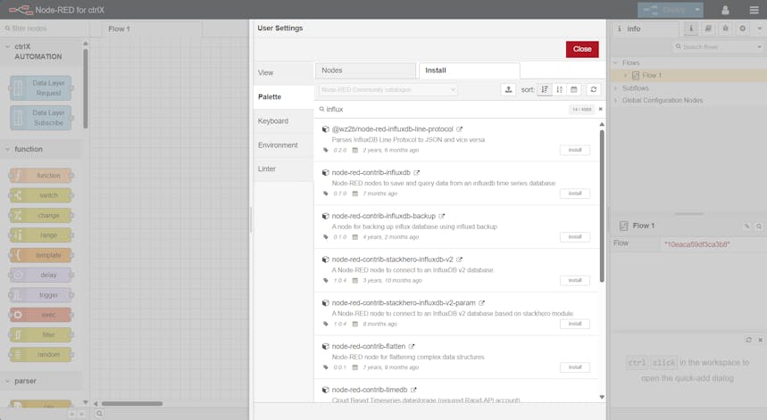

Install  "node-red-contrib-influxdb 0.7.0" to store information in InfluxDB through NodeRed and/or any other NodeRed plugin.

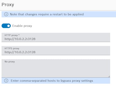

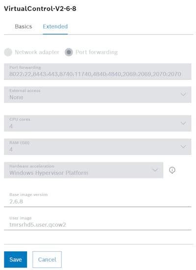

- CtrlX Core - Proxy Configuration (http://10.0.2.2:3128) - "Port-forwarding mode"

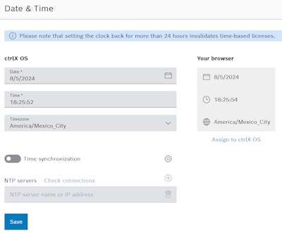

- CtrlX Core - Date & Time updated
- Virtual Core Settings

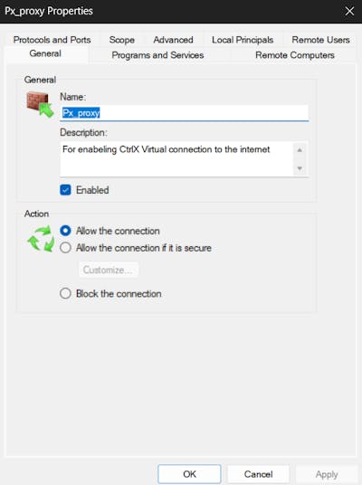

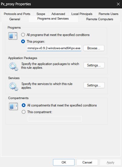

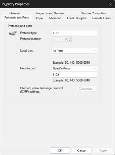

- Firewall Inbound Rule for Proxy
Â
Â
Â

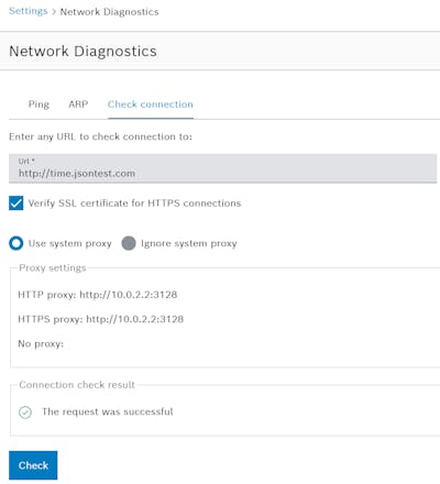

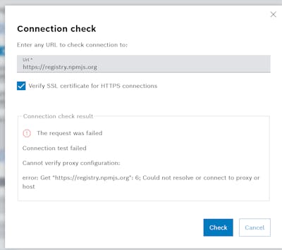

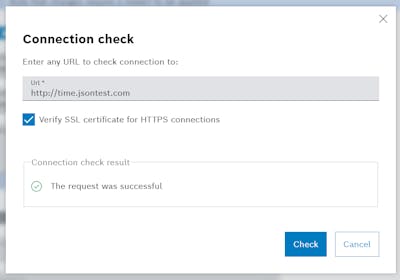

When doing an HTTP connection check, the Core is connected to the Internet
Â
But when trying to install NodeRED plugins via the pallet manager it appears the following error for "node-red-contrib-influxdb".Â
Â
Â

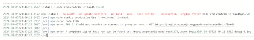

2024-08-05T23:46:12.762Z Install : node-red-contrib-influxdb 0.7.0
2024-08-05T23:46:11.417Z npm install --no-audit --no-update-notifier --no-fund --save --save-prefix=~ --production --engine-strict [email protected]
2024-08-05T23:46:12.043Z [err] npm warn config production Use `--omit=dev` instead.
2024-08-05T23:47:23.598Z [err] npm error code E502
2024-08-05T23:47:23.602Z [err] npm error 502 6; Could not resolve or connect to proxy or host - GET https://registry.npmjs.org/node-red-contrib-influxdb
2024-08-05T23:47:23.604Z [err]
2024-08-05T23:47:23.605Z [err] npm error A complete log of this run can be found in: /root/snap/ctrlx-node-red/1273/.npm/_logs/2024-08-05T23_46_11_889Z-debug-0.log
2024-08-05T23:47:23.625Z rc=1Â
Â

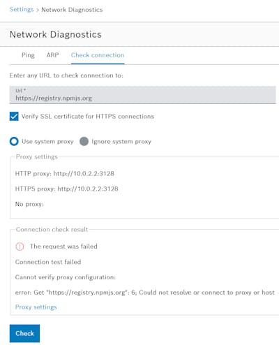

When trying to check the connection to "https://registry.npmjs.org"Â through the web interface appears the following:
The date & time is already synchronized with the browser & Laptop time
Â

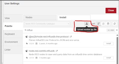

Workaround (not solution)
A workaround I managed to do is to download the InfluxDB package locally to the PC, and then upload it to the CtrlX Core by using the following link structure and copying it to any browser.Â
 https://registry.npmjs.org/[PACKAGE_NAME]/-/[PACKAGE_NAME]-[VERSION].tgz
- Example on link structure with InfluxDB package Version 0.7.0
- https://registry.npmjs.org/node-red-contrib-influxdb/-/node-red-contrib-influxdb-0.7.0.tgz
- PACKAGE_NAME: node-red-contrib-influxdb
- VERSION: 0.7.0
- If you need an older version of the plugin, it can be installed by only writing the desired version on the URL.
- You can find the package names in the following link
- To Install click on the following button in NodeRed Pallete and select the ".trz" plugin.
Â
Â
