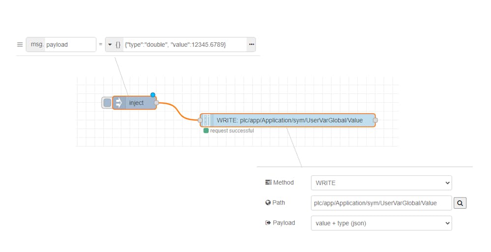

Check that the message payload passed to the WRITE block looks like this:
Also, remember that double correspondes to IEC-61131 type LREAL:
