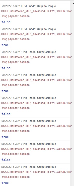

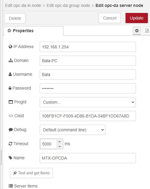

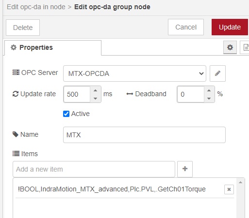

I ran a simple PLC program on my MTX system (an output turning ON/OFF every few milliseconds). The OPC server details from the MTX were configured in the OPC DA node in Node Red (see pic OPC-DA-1.jpg). The corresponding PLC variable is configured in OPC DA as shown in pic (OPC-DA-2.jpg).  The flow was setup in Node Red as shown in pic OPC-DA-3.jpg. As can be seen in pic OPC-DA-output.jpg, I  was able to successfully get the variables from MTX into Node-Red using the configured OPC-DA node.
