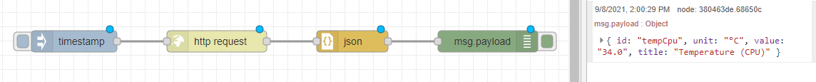

Working: issuing command from localhost, ie: Node Red running on the same CORE where I am directing the GET request.  You can see the flow and the result in the working.png picture and FlowWorking.txt files attached.

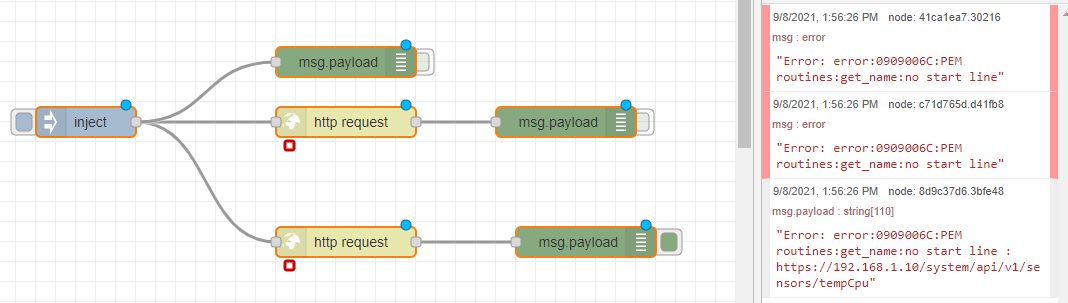

Not Working: issuing the same command from a different device, trying to issue the GET request to the other CORE IP address.
For the GET request, I get this error:
"Error: error:0909006C:PEM routines:get_name:no start line : https://192.168.1.10/system/api/v1/sensors/tempCpu"
I tried a variety of different ways of using certificates, keys and tokens to get the command to work, but none have worked.  I used the certificates and keys, in various combinations from the "Web Server" section of certificates and keys on the CORE, of whose temperature I would like to read.
I looked at the documentation on the REST API that described obtaining the bearer token.  I tried this in YARC and it works fine.  The same POST command from Node Red also returns a similiar error such as this one:
"Error: error:0909006C:PEM routines:get_name:no start line : https://192.168.1.10/identity-manager/api/v1/auth/token"
I have seen Node Red examples elsewhere for data layer, but nothing for the APIs, like the System API.
I'm out of ideas...any advice or code examples of how to do this?

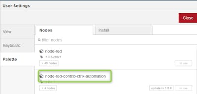

  1. why don't you use the standard ctrlX contribution nodes available in NodeRed and GitHub?
    There is also an example how to read the actual CPU utilisation.

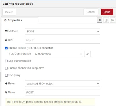

  2. You can get a token like you do with the YARC also in NodeRed:
    1. I build up my message:
      var newMsg = {};
      newMsg.header = {};
      newMsg.header["Content-Type"] = "application/json"
      newMsg.payload =
      {name: boschrexroth, password: boschrexroth}
      newMsg.url = "https://192.168.1.2/identity-manager/api/v1/auth/token";
      return newMsg;​

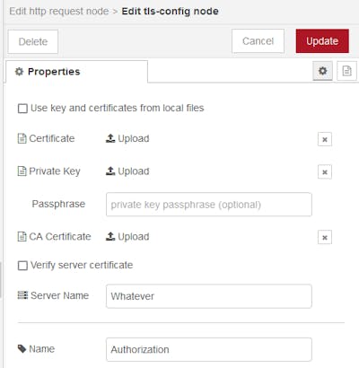

    2. And then activate SSL/TLS and send a POST:
