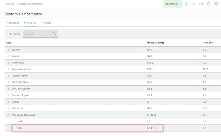

we have updated two CtrlX Core 3 to the latest version 2.6.

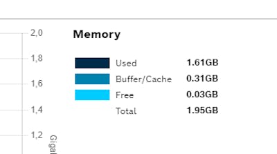

After nearly one day the whole memory RAM has been allocated by the Core. For us it seems to be strange since one CtrlX Core only runs in a testbed without much traffic. The memory is not released until the Core is getting restarted.

it seems that there was a bug in reading explicit defined nodes within the KVD nodes.json file.
It will be fixed with the next release.
