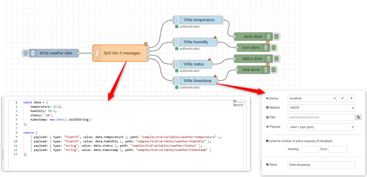

How can complex JavaScript objects (not arrays) be stored in the Data Layer via Node-RED?
Best reply by DraganX
one possibility is to do this using the KVD app. For that, you need to create a flow — one example looks like this:

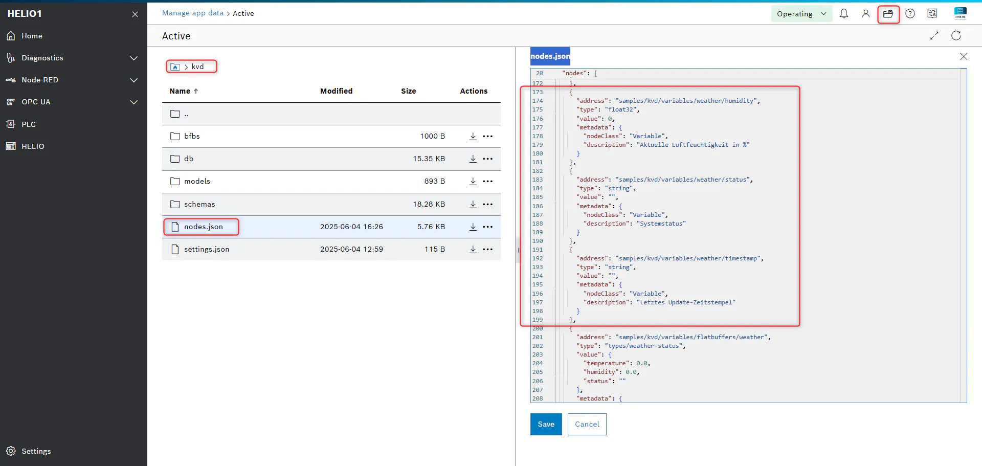

You also need to add the following to the app's data → kvd → nodes.json:

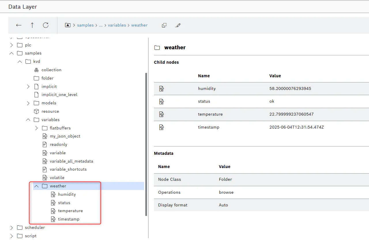

Then, it will appear in the Data Layer like this:
