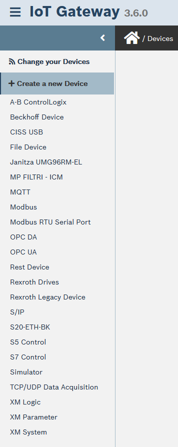

Hi all,
IoT gateway on PR21 has the functions to read the data simply what I mentioned on subject.
How to implement on ctrlX?

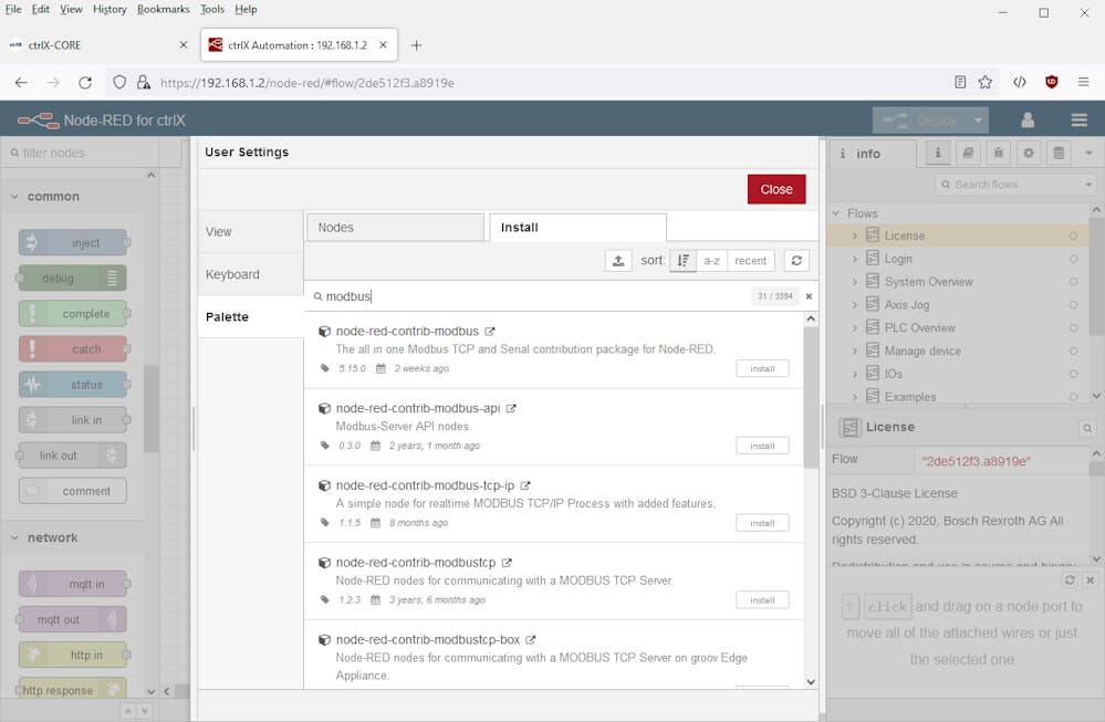

Our IoT tool running on the ctrlX CORE is Node-RED. There are extensions for several endpoints available as palletts:
