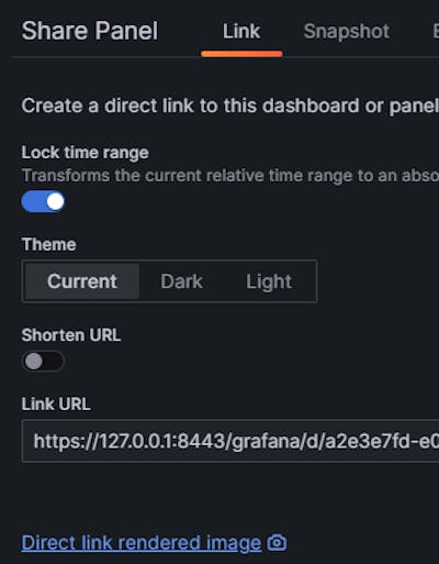

I downloaded and installed the Grafana image renderer grafana-image-renderer-3.11.1.linux-amd64.zip to the IOT Dashboard Plugins App Folder. I changed the grafana.ini file as follows:
[plugin.grafana-image-renderer]
;rendering_timezone = America/New_York
;rendering_language = en
;rendering_viewport_device_scale_factor = 2
;rendering_ignore_https_errors = true
;rendering_verbose_logging =
;rendering_dumpio =
;rendering_args =
;rendering_chrome_bin =
;rendering_mode = clustered
;rendering_clustering_mode = browser
;rendering_clustering_max_concurrency = 5
;rendering_clustering_timeout = 30
;rendering_viewport_max_width = 1000
;rendering_viewport_max_height = 500
;rendering_viewport_max_device_scale_factor = 4
;grpc_host =
;grpc_port =
. As I click on a panels' share, I can see the image rendering option, see below.

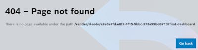

Unfortunately, after clicking the link, it errors out with Page Not Found, see below.
Is grafana Image Renderer not supported within the IOT Dashboard app?
Best reply by Sgilk
Tamas ,
I set this up locally and confirmed that a number of the libraries required for Chrome are missing in ctrlX OS. Unfortunately, this plugin will not function.
