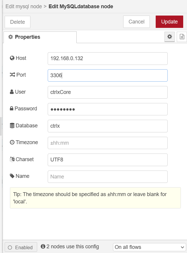

- Inside Node-RED MySQL database node:
Host: 192.168.0.132 (my computer IP where database was created/installed)
port: 3306
user: ctrlxCore
password: password
database: ctrlx
Charset: UTF8

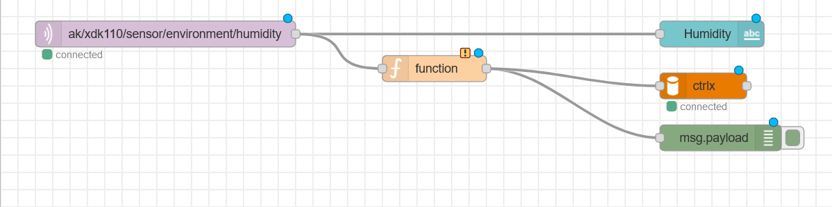

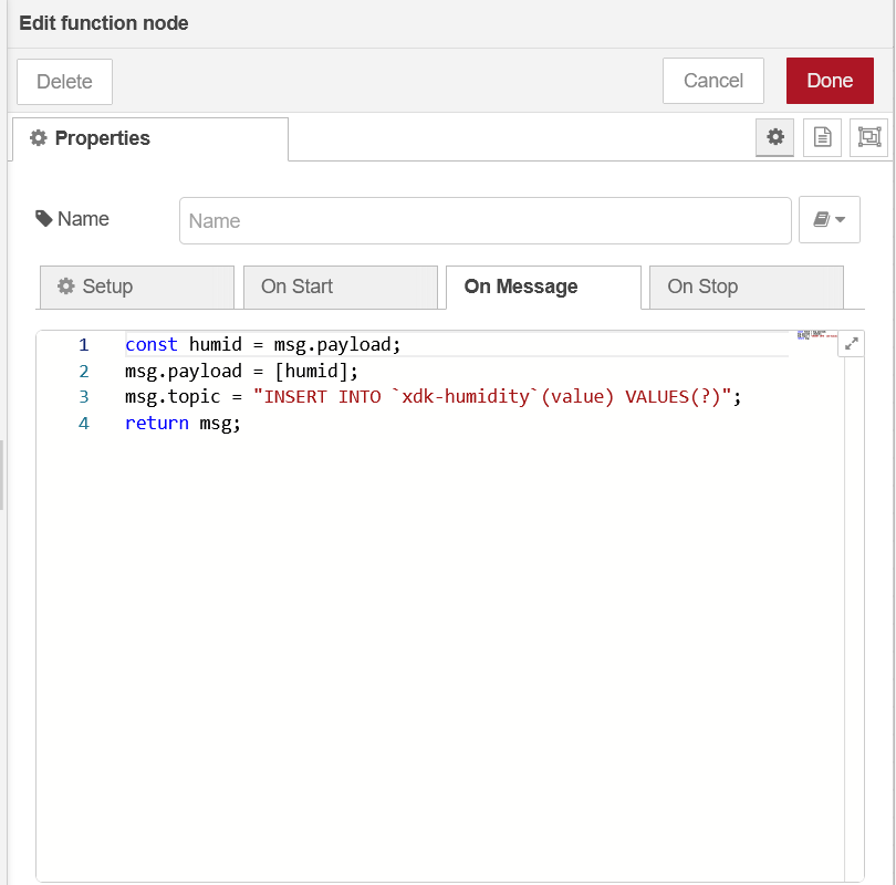

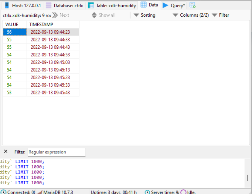

In HeidiSQL, I dropped the previously created TABLES and created a new and simple TABLE to get values from mqtt-in node:
CREATE TABLE humidity (
VALUE VARCHAR(100),
TIMESTAMP timestamp NOT NULL DEFAULT current_timestamp() ON UPDATE
You can refer to my Node-RED flow as per attached screenshots.
