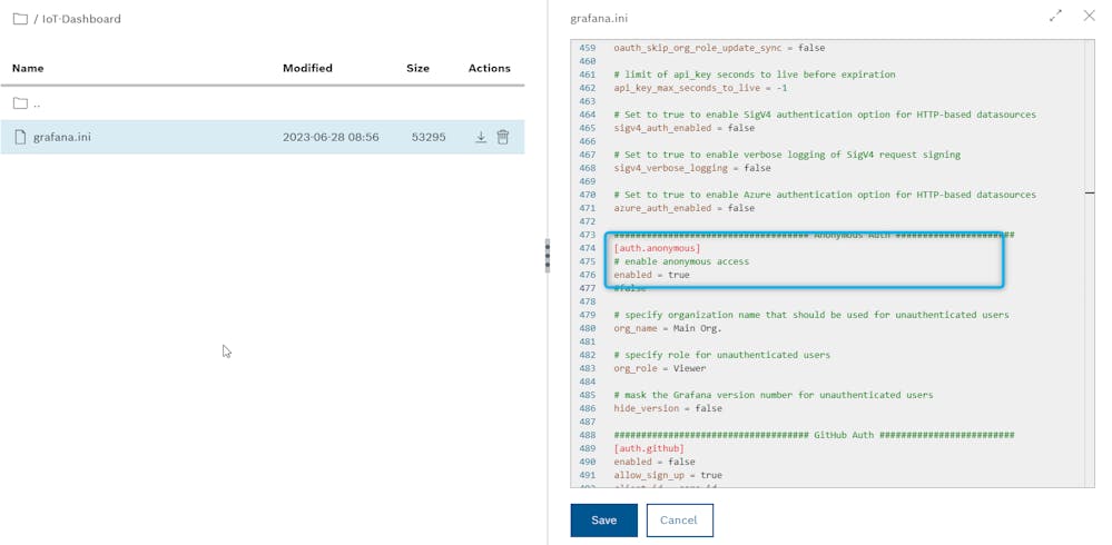

I am trying to display a grafana dashboard in my WebIQ application via iframe. I found a couple of problems with the Grafana configuration that I don't believe can be modified with this version of the IoT Dashboard (1.20.0+9.3.6).
First off, embedding is not allowed, so iframe will not work here.

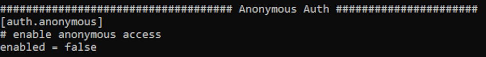

Also, anonymous authorization is disabled, so authentication will be required to display dashboards.
Is there any plan to allow .ini configuration changes to the official IoT Dashboard app?
Best reply by MauMX2
Hello Sam,Β
It should be possible, modify the grafana.ini in the active directory!! But don't forget to save and reboot 😎
