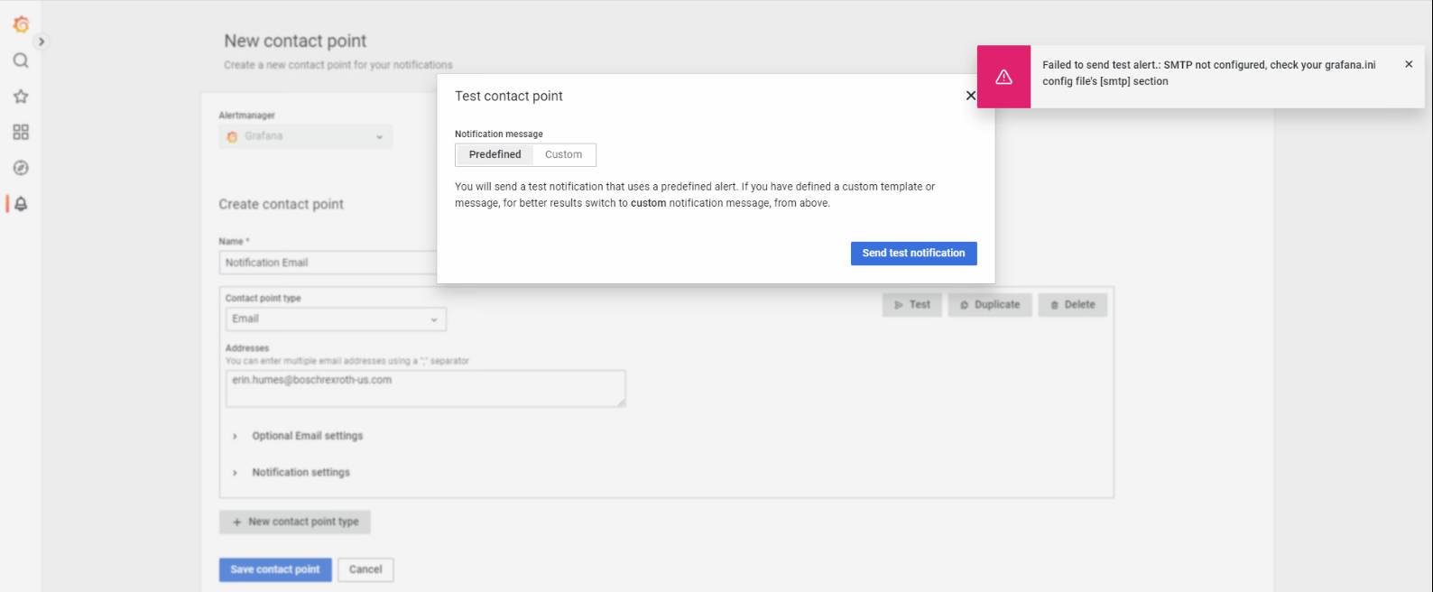

I want to send an email when an alert is fired. When I set up a contact point and a notification policy to test it, I recieve the message shown in the attached image. Could this message be explained, as well as a way to solve it?

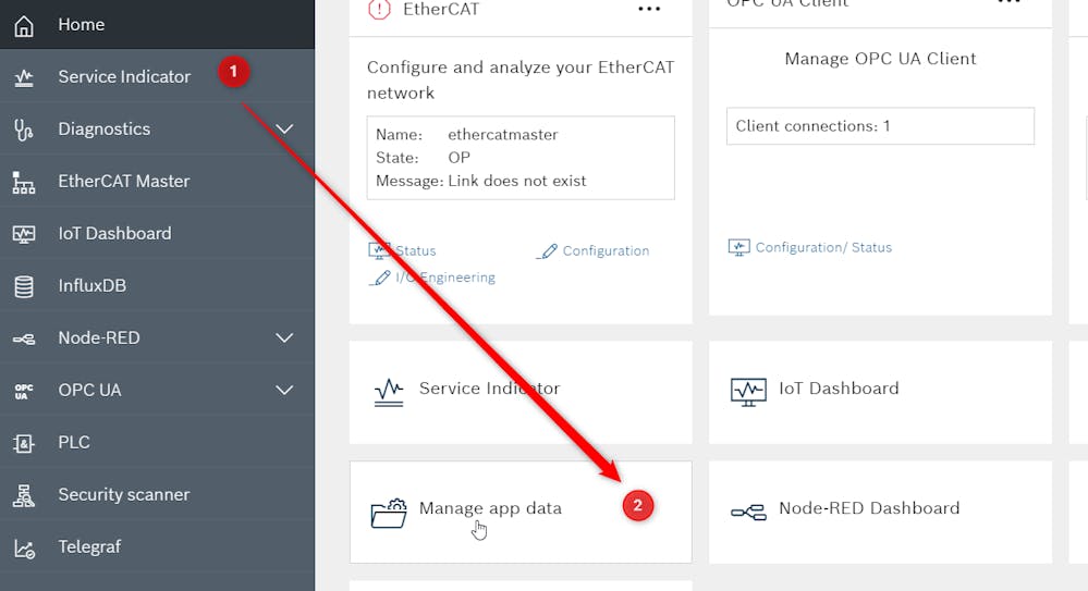

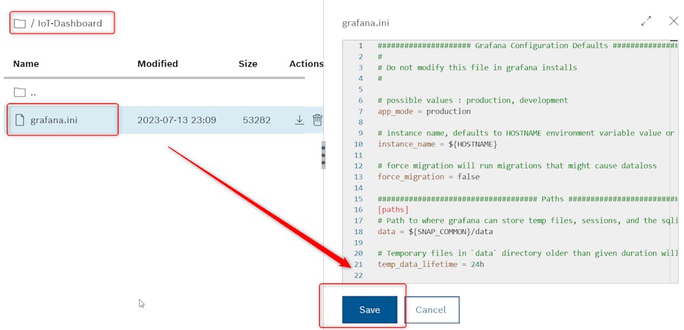

From version 1.20 is possible to modify grafana.ini file from app data:
You have to modify and reboot the device. the settings you want to include should be seen in Grafana manual.
https://community.grafana.com/t/smtp-not-configured-check-your-grafana-ini-config-files-smtp-section/29220
